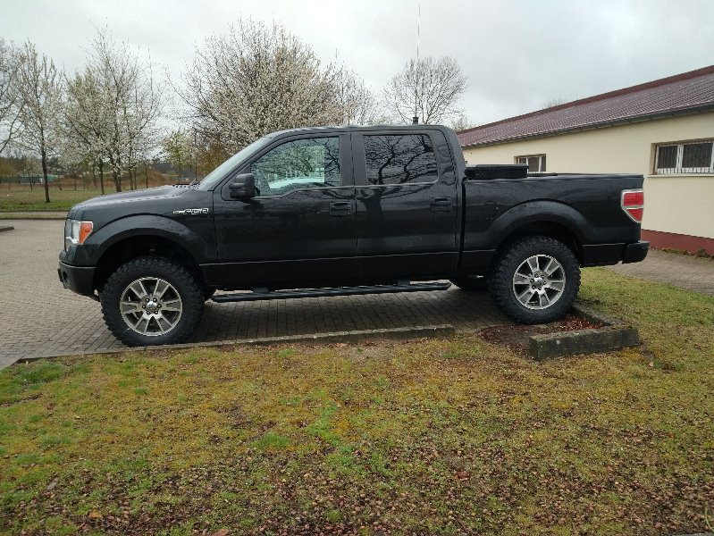

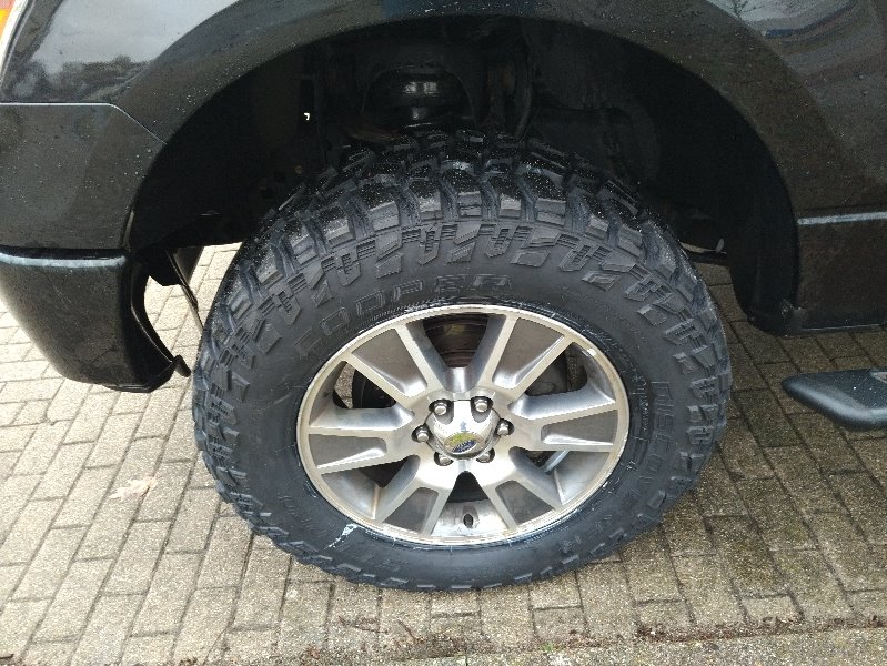

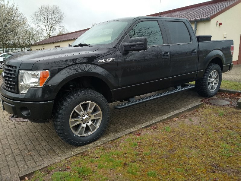

Just put on my 3 inch lift kit and 35 inch tires. This truck is looking awesome!
Lift: Motofab 3 inch level with 2 inches in rear.
www.amazon.com/...r=8-5
Tires: Cooper STT pro 295/65/20 (35 inch)
us.coopertire.c....aspx
Going to the big off-road Expo in Bad Kissingen with it 20-23 June.

Yes, I installed it myself and it was NOT easy. It took my 4 hours with power tools. The problem with 2014+ is the two bolts holding the strut to the lower control arm are pressed in by Ford and impossible to remove, so lowering the axle and lower control arm enough to remove the strut was a nightmare. But it's done and I love it. Lesson learned, take it to a shop and let somebody else have the headache. LOL
